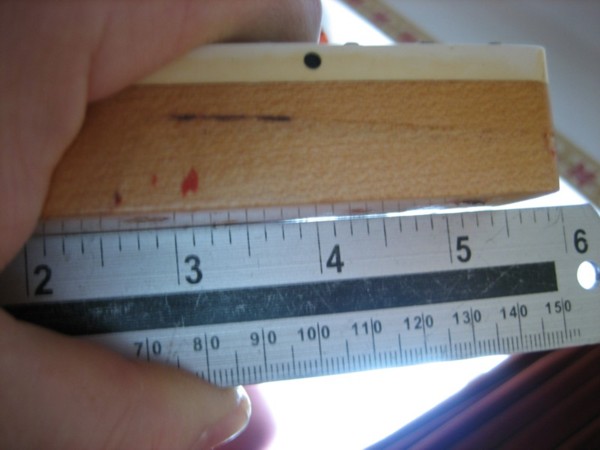

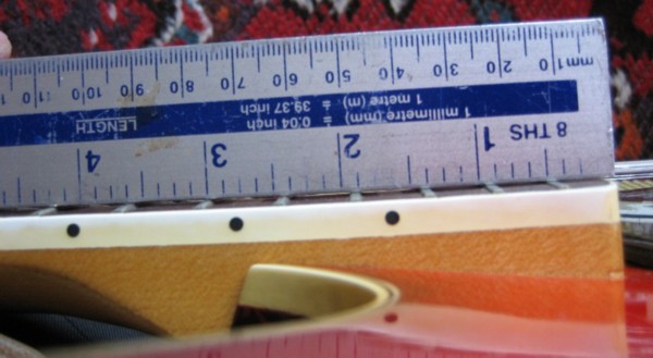

I'm working on a Fender Coronado XII whose neck has been shimmed, obviously a long time ago. It's a good illustration of why you should put a full-sized wedge in the neck pocket rather than just shim the neck right at the end. As you can see from these two photos, with the passage of time the neck has kicked up right at the end of the fingerboard. It was brought to me because it wouldn't stop buzzing, which must have been a problem for a while because as you can see the last couple of frets had already been filed almost flat.
